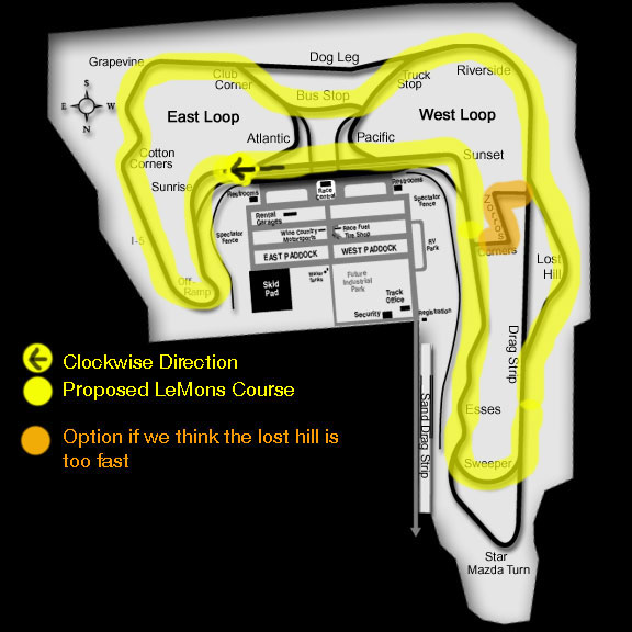

Okay,
According to Google Earth and the projected Buttonwillow LeMons track, the short version is about 2 miles per lap and the long version is about 2.7 miles per lap.
Consider the following data:
Fuel Tank     |  Average MPG  |  # Short Laps per tank  |  # Long Laps per tank
Stock, 9gal52216
9gal + 5gal53526
Stock, 9gal83626
9gal + 5gal85641
Stock, 9gal104533
9gal + 5gal107051
Stock, 9gal12.55641
9gal + 5gal12.58764
Stock, 9gal156750
9gal + 5gal1510577
From a previous Buttonwillow LeMons event, the winner's average lap time was 2:50mins completing 281 laps total. I am not sure which track version this was raced on. Here is the data:
Fuel Tank     |  Average MPG  |  Hours Per Tank if Short Laps  | Hours Per Tank if Long Laps
Stock, 9gal51.070.79
9gal + 5gal51.661.23
Stock, 9gal81.71.26
9gal + 5gal82.651.96
Stock, 9gal102.131.58
9gal + 5gal103.312.45
Stock, 9gal12.52.661.97
9gal + 5gal12.54.143.07
Stock, 9gal153.22.37
9gal + 5gal154.973.68
edit: Additional calculation of this data shows that the 1st place car either averaged 42 MPH (if they raced the short track) or he averaged 57 MPH (if long track). Hey Bryan! What was your lap time again in the MR2 on Buttonwillow for the full length track?
